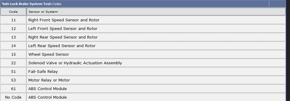

There are two ways to check for error codes:
If you have a Super STAR II or equivalent engine code scanner, you can perform a quick test on your anti-lock brake system to see if there's anything wrong. Simply connect it according to the manufacturer's instructions and write down the codes that appear. Codes are listed below.
Set the meter to read between 0 and 20 volts. Remove the driver's seat. Find the four-wire connector on the ABS control module. Without disconnecting the connector, connect a jumper wire between the check terminal wire (Green/Black) and the ground wire (Black).
Connect the positive wire of the voltmeter to the Green/Red wire on the ABS control module connector. Connect the negative wire on the voltmeter to a ground.
When you're ready to start the test, start the engine. If a continuous error code is present, it may be necessary to drive the vehicle to try to re-create the fault event.
See below for how to interpret the pulses.
Interpreting the Codes
The pulses on the voltmeter translate into single digit codes. Every time the needle on the voltmeter sweeps across to 12 volts and drops back to zero, that is considered one pulse. Codes are displayed by the number of pulses the voltmeter displays. So three pulses would indicate an error code 3. If there is more then one error code, they are separated by a longer pause.
In addition to the voltmeter, you will need to keep an eye on the ABS warning lamp during the test as well. The lamp will either flash on then off once for each code, or will stay illuminated. A flash or a continuous illumination of the ABS warning lamp will be part of determining which fault is present.
